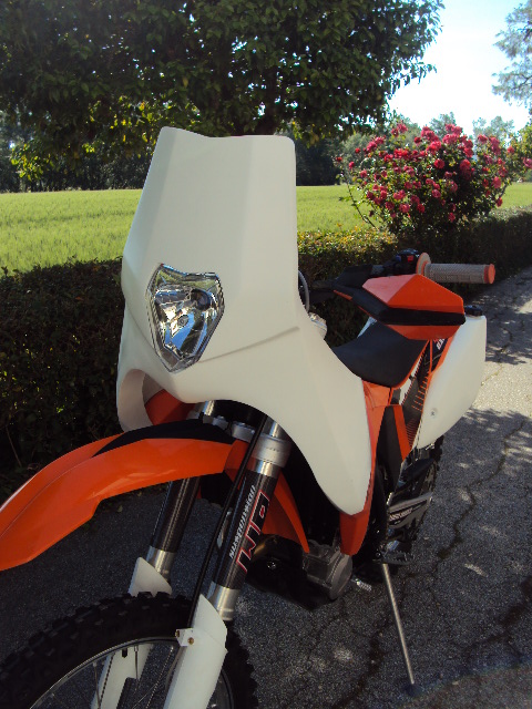

Where can I obtain an awesome fairing such as this???
Looks great.
We are the US importer/dealer for Alberto Dottori rally kits. Send me a PM.
This kit is available for the 13L front or Acerbis 5.3 gallon tanks, and Dottori's 5L rear tank. I have found the 13L + 5L combo to be great for non-Dakar rallies (such as the Sertoes, etc.) It's a nice, tight, well balanced setup. With the FI, the bikes get even better range.
