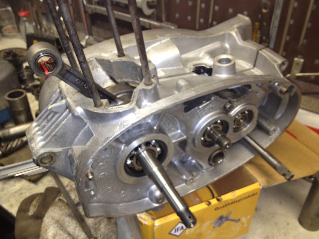

News from the front! Great progress with the engine, though a problem has a risen!
This gearwheel carries the clutch and is also the primary wheel to the gearbox.
It needs to be shimmed to have 0,05mm. of play, but as you can see on the picture, the washer that is going to be laid over the gear here, will create 0,0mm. tolerance, as the gearwheel with shim (lies beneath the gear) is taller than the "step" on the crankshaft.
MZs have had various sizes gears and the needlebearings that it rolls on.
Here is another gear, but this is way too small, creating a play of ~2mm.
The two gears. So the question now, how the F do I get the correct gear? Oh yeah, different ratioes are also in play here.
Old 04-28-2012, 11:35 PM   #116
LasseNC OP
XSessive!
LasseNC's Avatar
Oddometer: 946
This might explain it a bit better.
1. Shim
2. Needlebearing
3. Washer
4. Springwasher
The odd clutch assembly.
