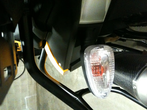

First of all my side rack fitment is less than optimal and the right side frame rubs against my body work next to my fuel filler. I have a rubber pad in between to minimize bodywork damage.
I have any slotted holes aligned to mount the rack at its most outward position (makes no difference).
Anyone else having poor rack fitment?

As far as the fit of the rack itself, seems to me that you got a poorly fitting rack and I would contact Wolfman. I have dealt with them directly and found their service to be top notch. They would be surprised to hear that the rack is touching the bike. They are good guys. Give them a call.
I was having the same fitment issue you are. However, I called Berg Briggs at Back Roads Moto (the guy who makes the racks for Wolfman), and told him about the fitment issue. He then proceeded to fabricate a new set of racks with 4mm more room in the conflicting spot (shown in your picture). He sent them to me, and they fit perfect. Ample space between the bars and my bike. So, you may want to call Berg and ask him if you can get the new revised version instead:

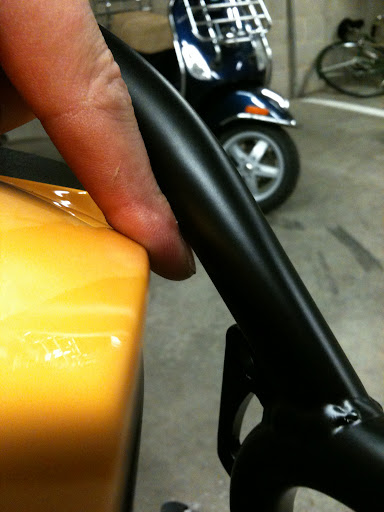

As you can see, the new updated version has some additional mount points. It apparently creates the possibility of mounting some other types of bags besides the Wolfman Expedition Dry Bags:
Ass view:
Total clearance on left side:
Total clearance on right side:
I can get my finger in between the plastic and the tubing:

Thanks Griz. Not that much clearance on my bike, and I hope for a simple properly bent right rack. I don't need all the extra fasten points really.
Simple is good.
