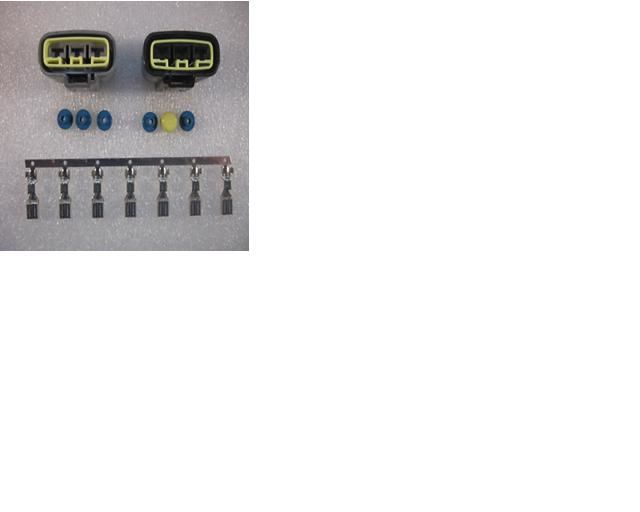

I will have to dig for the complete reference, but I believe that a Yamaha R1 regulator will work far better because of the MOSFETs used internally. Requires the harness plug to be spliced but that is pretty easy. The R1 regs run much cooler and as a result typically will last a very long time. Voltage regulation also tends to be more in line with ~14.2Vdc.

Yamaha PN: 1D7-81960-00-00
Requires plugs: FURUKAWA CONNECTORS

This is nothing like the Chinese rubbish that I tried
The KTM ones do not last long enough. This looks to be a good solution to an on going problem.
http://www.ebay.com.au/itm/YAMAHA-SH...item588d8645ad
Or maybe the kit
http://www.ebay.com/itm/ws/eBayISAPI...DER:SIMPLEITEM
Might just grab one

Anyone found the OEM connector?
How do you connect to the OEM loom? Did you find the manufacturer of the OEM brown plug the yellow wires connect to?
