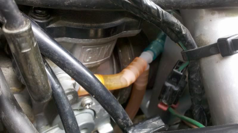

LED Blinkers. Fixed.
Here are some pics of the LED Load Equalizers that I used to fix my blinker situation. You just tie one into the circuit near each blinker. Less than 5 min. per, once you get the circuit worked out in your head, paper works great, too. If anyone needs help, I'll be glad to draw up a schematic, scan it, and upload it. It's your most basic circuit with one LARGE-ass resistor, lol.

whats the point of LED blinkers if you use the resistor to trigger the flasher... uses the same power as the incandescent bulbs. looks kooler is about all? why not change to a low current flasher.... just sayin

That's what they had at O'Reilly, in-town, same day. Not worried about the voltage atm, just looks. When I have some more of that magic green stuff that makes people give you stuff that you want, I'll be picking up a FEW more things, and the new switch is on the list, as I am still running the stock fronts for now. I do want to lose all of that voltage, so I will get it all rigged up. One (or two) things at a time Don't wanna get bored.
