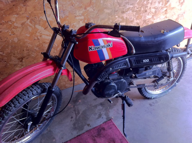

Hey guys, so i copied this thread from my personal message board and apologize if the context is vague or not to the level of detail expected on this site!
So this week i saw an ad on CL for a 1981 Kawasaki KE100. It was 300$ OBO and quite far away. But on a whim i emailed the guy and told him if he delivered i would pay $300. the photos werent great and the guy sounded relatively knowledgeable. But hell if he was willing to take the time to deliver it i figured i could roll the dice. Well roll the dice i did and its looking like 11 to the RIGHT!
When delivered the guy said it started but wouldnt run. We fired it and he was indeed correct it stalls almost immediately. However i noticed that there was no gas in the fuel line. The guy said he never even filled it up, sure enough it looked low but there should have been flow in the line. My thought: That the float valve was stuck causing an air backup in the fuel line. So rather than trying to rise the price with the guy there. I kept quiet and thanked him for the bike.
Tonight for the first time i got to dig into it. After removing the engine cover (the carb is inside the engine case!) and tapping on the carb bowl, i was able to get fuel flow through the line. Just a little gummed up. I put the choke on gave it a couple kicks and BAM lift off!
It is far too loud to be playing with at this hour with all the nieghbors, but next daytime oppurtunity we are looking good!
The rear tire is also thrashed. New DOT approved dualsport tire and tube $30. God these things are cheap.
The suspension looks to have the stiffness and travel of a pogo stickbut it seems to be complete, stock and in good condition. The bike weighs all of 150# and is on a good day 8 horsepower. From the factory this was a street legal bike, but it appears all the running gear is removed. Maybe someday, but for now this is the chick/learners bike and it will be super fun with enough camping and liquid courage. Hopefully test outing in 2 weekends.
My question for the inmates (That i think came up in another thread last week), should there be some sort of baffle or spark arrestor in the muffler of this KE100. Right now it is a full diameter opening at the end of the tailpipe and its awful loud! Suggestions?

So i monkied with it a little tonight with little sucess. The bike would occasionally start and run for about 30 seconds then stall. I cleaned the carb last night and it defintely ran best first kick today almost holding an idle off choke. But since then it has been erratic and occasionally starts. I have three hypothesizes:
1. Water in the gas - i have no idea where the bike had been stored and how old the gas is. I did add some but not much.
2. Float height - There should not be any air major air in the fuel lines prior to the carb right? We get good flow once i disconnect the fuel line to the carb and open the petcock. The carb overflow lines are also clean and flow freely. Frankly im a little stumped.
3. Oil Pump - I have read on various internet sources that it is easy for the throttle cable for the oil pump to get a little bound up and pump too much oil. It was tough to tell from the short time it was running if it was "too" smokey. I kinda doubt it though,.
Any suggestions are appreciated, these things are so simple yet complicated at the same time
Dump the fuel out of it for a start. If your unsure how old it is, best to start with fresh fuel. Id also put a new plug in it and either put a carby kit through it or fully disassemble the carb and give it a good clean. And put a new piece of fuel line in.
From there if it still plays up then you can go onto the next area.
Yeah, the more i have been thinking about it, i am going to drain and add fresh fuel. I had a CRF230 once that would start everytime but die for an undefined reason, clean carb etc... Turned out that it was just some water in the tank.

The stinger/muffler part you are missing is actually two parts you will have to look inside the muffler and see which you are missing. I only remember the end piece which if I remember is a necked down tube with and end cap with an opening about half open.

I will have to look again, but based off the diagram you posted it isnt looking good for either peices last i looked

It is common to have some air in the fuel line. Depends on the curvature of the line. On a horizontal run, an air bubble can stay trapped, but it should be a bubble not a completely empty line. If you pull the fuel line off the carb and open the petcock, you should get a solid stream of fuel. When it's connected only a tiny dribble actually goes into the carb once the float bowl is full.
Once you have good fuel and good flow to the bowl, if it keeps stalling you need to clean out the pilot jet. On modern carbs it sits vertically in a hole that is offset about 3/8" from the main jet and you need a small screwdriver to get it out. The main jet is hex shaped and is centered in the carb body. Your carb might be a bit different, see if you can find a parts diagram.
The engine won't run right if all the baffle parts are missing.

Neil is correct Pilot jet is one of the main problem on 99% of bikes running only with the choke on for a diagram on the Carb go to www.sudco.com they have every carb diagram and most specks . BTW you got a good deal on that bike

Thanks for the advice guys. My first inclination was a clogged pilot jet, however i have cleaned it pretty thoroughly twice. I realize that sometimes they just cannot be cleaned, but i think i got this one...
I have been out of town the past couple days and havent had a chance to monkey with it. Hopefully some time allows tonight for fresh gas!
