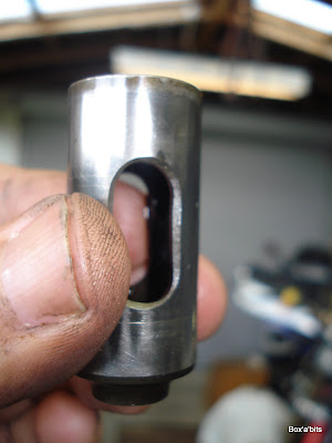

Originally Posted by Padmei View Post
Are they lightened cam followers pictured in that exploded engine?
Nope, looks standard-ish. These are out of Gus
Would be interesting to know what dimensions the pushrods were & how the barrel looked compared to a stock one
Yup
