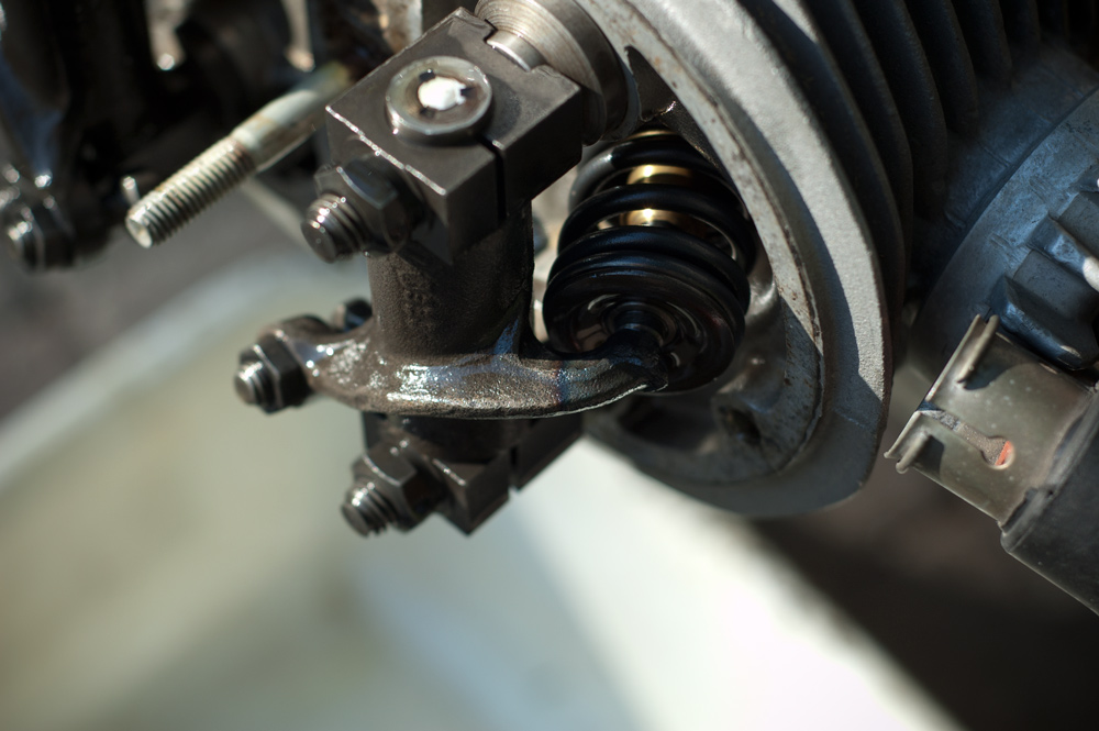

Hi guys, first post here.
Just bought a 29k 1978 R100/7, and I was going through the mechanicals and fluids and came across this:
This is the right side exhaust rocker arm, and none of the other arms show any similar signs. Push rods rotate freely and smoothly at TDC compression for both sides, and there doesn't seem to be anything wrong with the valve guide or the valve stem. The valve clearances were the same right and left, though the exhaust ports were about .18mm and .15mm is called for on r100 so I re-set to .15 after adjusting end play. No signs of trouble yet, but I'm wondering if this is bad news?
Thanks,
Ryan

They all look like that, part of the hardening process.
Not all.
That process started in late 1976 (IIRC).

Not bad news now that you have it adjusted properly, but someone let it get (or set it) too tight at some point.

That rocker looked like that before it was ever in a bike. They heat treat the tips to harden them.

Thanks, this is a relief. Strange that it's only this one arm with visible bluing, but I'll rest assured now.
