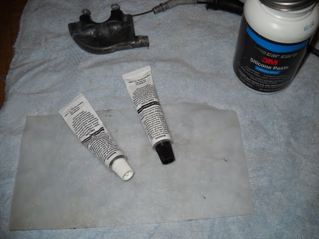

greasy silicone
I bought something like this from Amazon - http://www.amazon.com/3M-Silicone-Pa...silicone+paste
I use it for many purposes. Works great to slick back my hair before a hot date.
