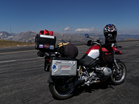

Rotopax, mounted to a pillion plate.
I carry a gallon of gas under a gallon of water, under a drybag. (they also make a 2 gallon size, but it won't fit between the handles on the rear GSA luggage rack unless you raise it an inch or so)

In the top picture you can see the stainless steel handle going across the near end of the gas can.(it's not as close as it looks, but the 2 gal won't fit between) The bike is a standard GS, but I put on the GSA rear rack which has those handles. The regular GS don't have them so the wider 2 gallon size will fit fine. It could also be shimmed up an inch to go over those handles on the GSA rack.
Rotopax is expensive (for a gas can) and I've left it in the sun on 100+ degree days with no leakage. I've ridden several thousands of miles in 7 western states in all kinds of weather and never had a problem.
Edit; There is a similar gas can called Kolpin. I have no experience with it, but I've heard complaints that they sometimes leak, and aren't as well made. I've never heard of a leaky Rotopax, but obviously, it's possible.

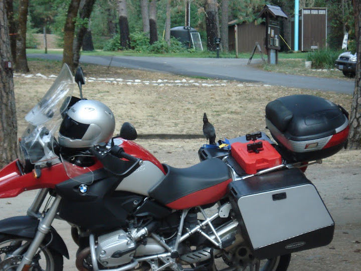

Originally Posted by WADE-O View Post
Looking at doing a trip and may need to strap some extra gas to the bike. What is a good gas can that won't leak if it is strapped to where the passenger seat normal would be? And i am probably going to have a duffel bag on there as well that will have tent and other camp odds and ends in it there as well.
Another vote for RotoPax. I carry one that I mount to my OEM Vario top case. It's just strapped on with quick release buckles on 1" nylon straps. The 'handles' that the straps go through are just cheapie drawer-pulls that I mounted to the top case..they provide handy attachment points for all kinds of stuff. I mounted four of them with short ss bolts, bedded in RTV to keep the holes waterproof.
