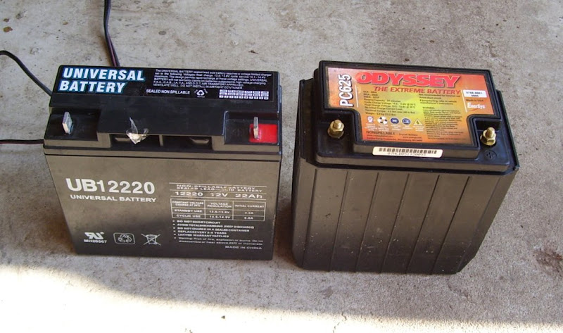

I have yet to see the glamour of the Odyssey batteries...I have bought the Universal Battery UB12220. More CCA and more amp hours than an Odyssey. And for those that say the Odyssey will last longer, my response is that I can nearly buy 3 of the universal for the cost of 1 Odyssey.

I personally have used the Odyssey pc625 for the last few years.
it fits the 1100gs easily, but I remember now, my ABS box has been removed, so maybe it wont fit if you have abs
its stronger than the pc680, and cheaper, more CCA, more reserve, and $20 cheaper.
http://www.odysseybattery.com/powerspecs.html
I had the ub12220 it wouldnt barely crank the bike over especially when cold, and I hit a bump offroad ( a culvert actually) and it totally died.
the pc625 was $72.50 from my local battery store when I bought them ( UI bought 5 of them in 2005 for use in PWCs, they did duty in those for a few years, then I robbed one for my bike after the ub122220 died.
it is a far superior battery to a simple SLA
