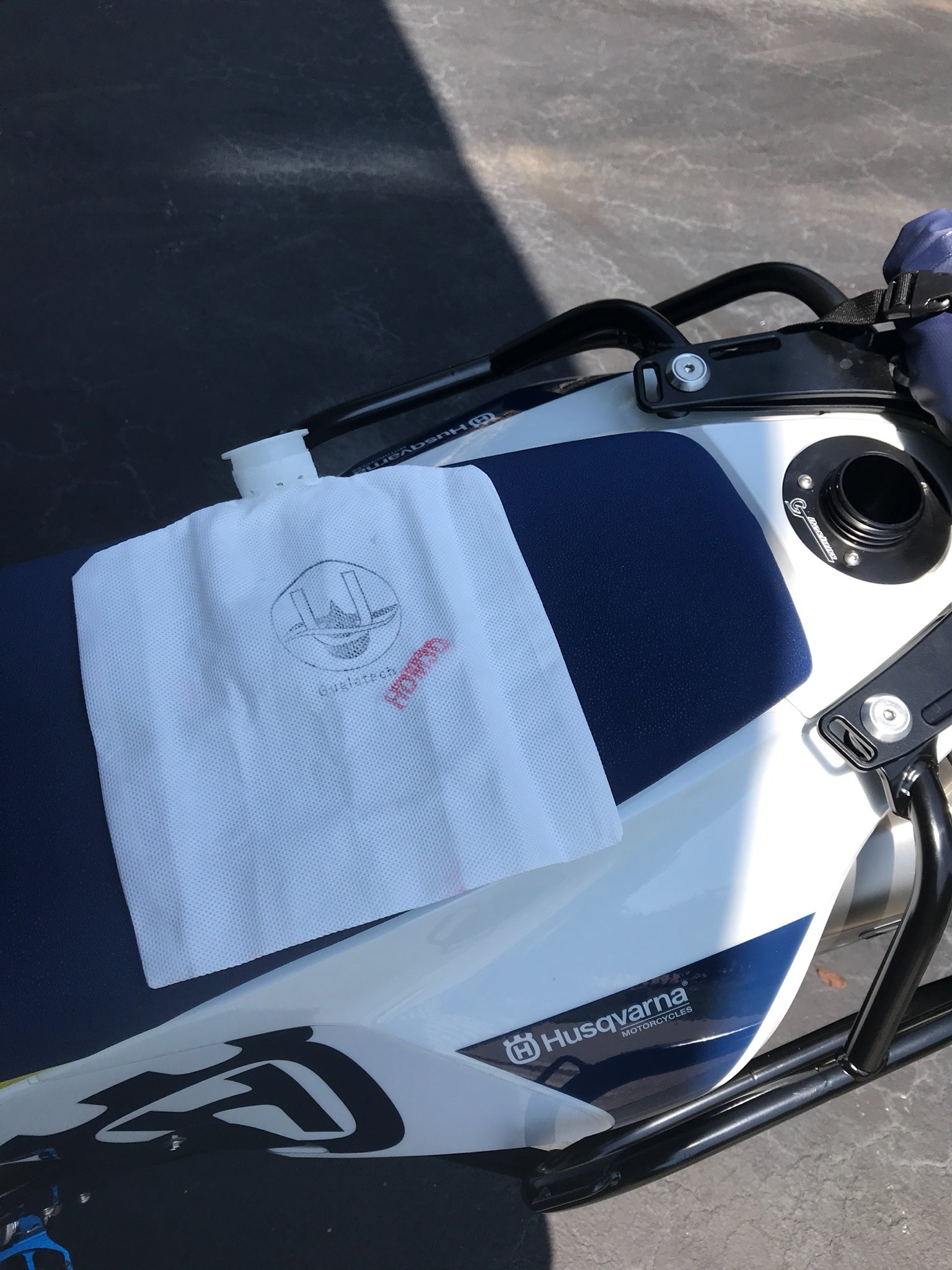

    I guess so far, none of us here have the Guglatech pre fuel filter ?
    This will be my second try at one. Th 1st was the Twin Air and it was impossible to fill the tank with fuel at the pump. Would take about 30 mins with fuel sprayed all over. That got tossed into the dust bin.
    But the Guglatech was $100 and Im hesitant to shove in the tank making it unreturnable if it will not work.

    My 990 prefilters are Australian (Profill?) and only about 3” x 8”. I’m pretty sure the Gugle guy says they are not a fine enough filter but hey, life is a compromise. If you pull them and check them after filling (takes 2 seconds) you can catch any water and toss it before it has a chance to (slowly) penetrate through the filter. Been working for me for years.

    Are you guys aware of the Profill inlet filter which installs at the pump? I have had very good results with these and have not used the filler neck style you are discussing. Just wondered...

    Question from someone who doesn't have one of these, but would like to. :D
    Why is this fuel filter necessary?

    Not really needed in normal urban use but if you end up getting fuel from a old filling station with dirty tanks it helps stop the dirt before your pump filter, if the pump filter gets blocked it can cause problems for the pump.
    If you're traveling in areas that supply fuel from drums etc then it's really needed.
