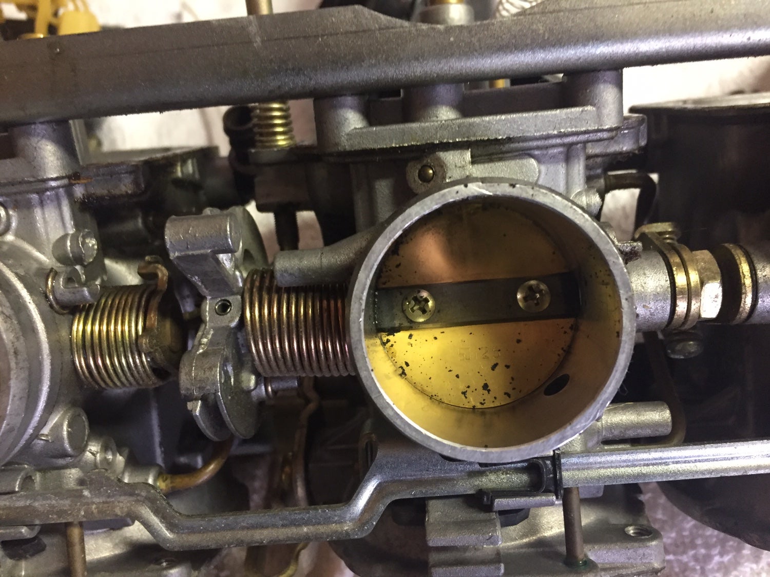

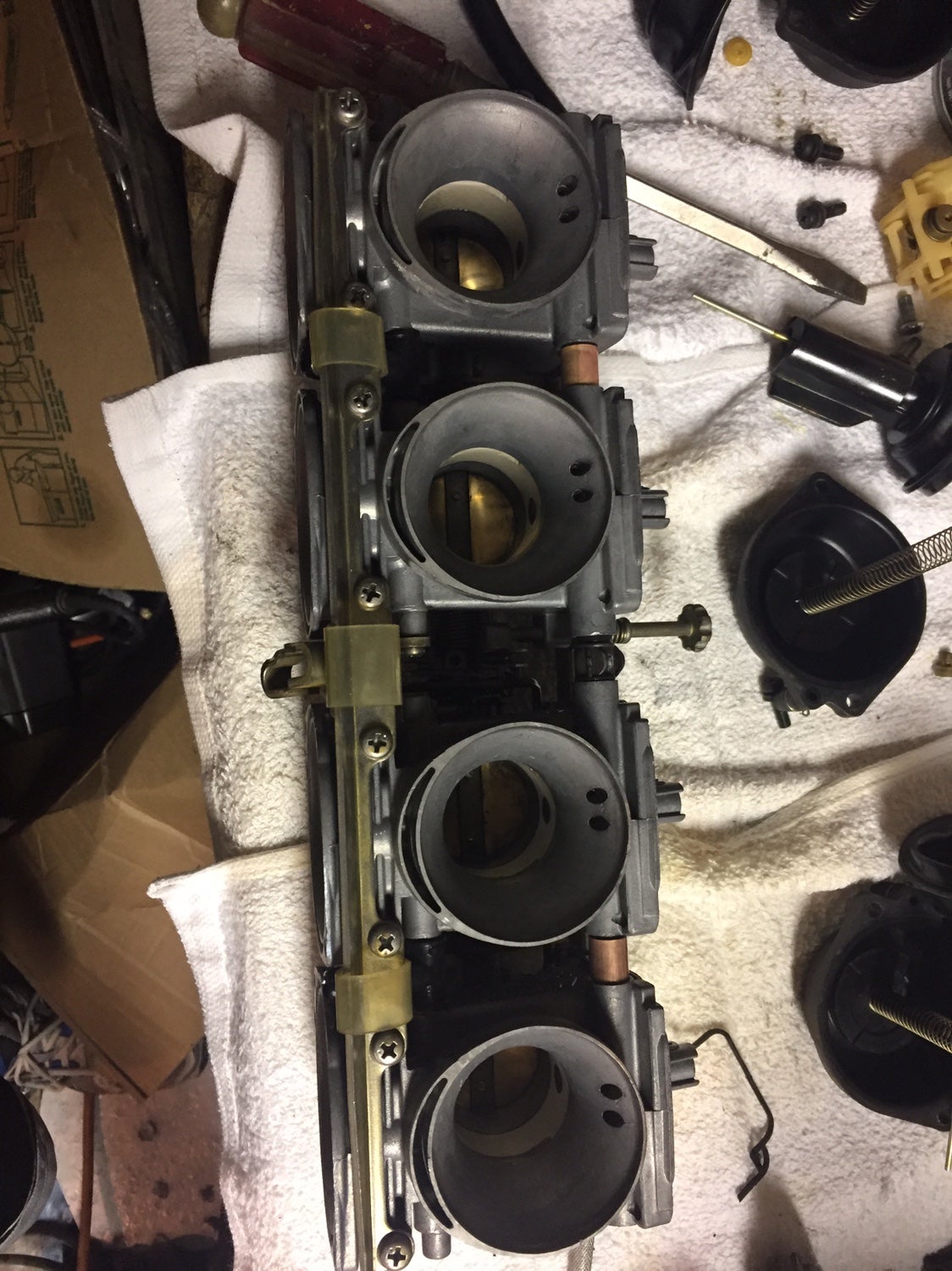

  10. husky390
    husky390 Long timer
    Joined:
    Sep 25, 2017
    Oddometer:
    1,460
    Location:
    Colorado
    It's bath time.
    [​IMG]
    [​IMG]

  12. husky390
    husky390 Long timer
    Joined:
    Sep 25, 2017
    Oddometer:
    1,460
    Location:
    Colorado
    So I dropped the carbs in the tank Saturday afternoon and pulled them out tonight. It did liquefy some of the gunk which made it easier to clean, it did cause some surface rust on the brackets that connects them, and it helped free up the butterfly valves that were sticking. I had to work them open and closed, sprayed them with carb cleaner and worked them some more for them to free up enough to where they'll snap shut. I put the carbs back in the tank to let them soak a couple more days and hopefully clean up the rest of the gunk.

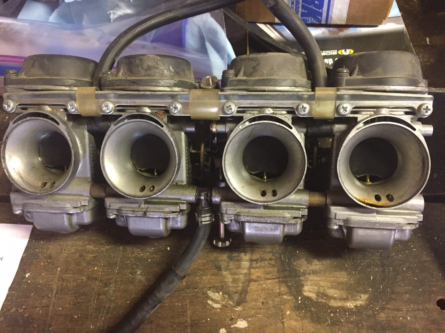

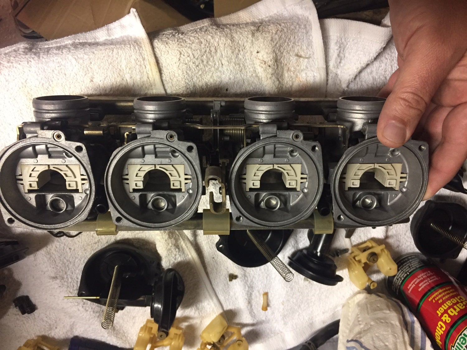

    husky390 Long timer
    Joined:
    Sep 25, 2017
    Oddometer:
    1,460
    Location:
    Colorado
    I'd say it was a success and I'd rather smell pine sol than Barryman's
    [​IMG]
    [​IMG]
    [​IMG]

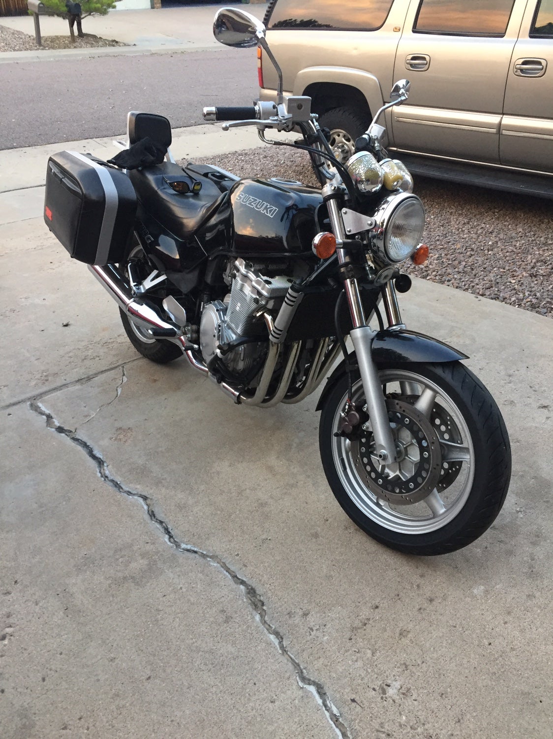

  20. husky390
    husky390 Long timer
    Joined:
    Sep 25, 2017
    Oddometer:
    1,460
    Location:
    Colorado
    It's alive and running great.
    [​IMG]
